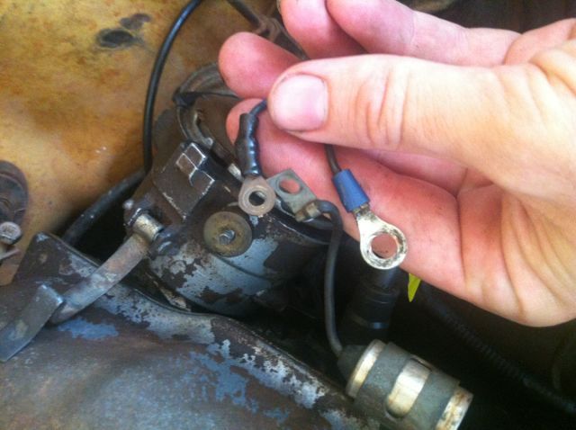

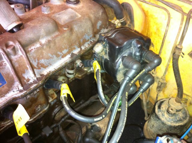

I had the same style dizzy as Dinka by the sounds of it, external coil, centre lead runs from dizzy over to coil, but my one does have points!
My mechanical dizzy has three wires connected to the top, one is just to the little condenser, the other two are a 12v ignition feed, and a mystery wire.
I pulled an electric dizzy with internal coil out of a Tercel at the wreckers, I didn't notice what year model it was, but everything under the hood looked younger than mine, despite the 400k kms it has on the clock! My Tercel only has around 280k.

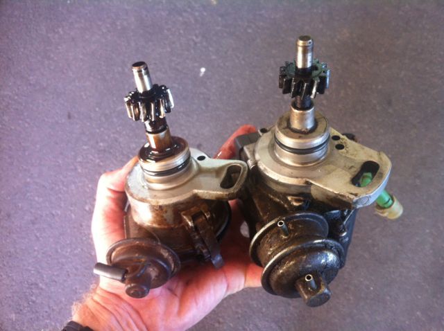

Side-by-side dizzy comparison:
as you can see, my little dizzy has only one hose port on the vacuum advance canister, and I don't know if either of them does something different from the one on mine... So when fitted, i just capped off the bottom one and ran my vac line to the one closest the dizzy body.
Now when it came to the wires, I just checked which of my wires was the 12v IG feed, and connected that one to the wire on the elec dizzy that has a red line on it.
The other wire I left unconnected.
I turned it over, and she started and ran perfectly!
The tacho still works fine, so as I said earlier, the other wire that was connected to my dizzy, which runs through the firewall, is a mystery wire.
I have left the old coil and all it's connected wiring how it is, just in case this dizzy dies for some reason, out in the middle of nowhere, I dont want to have to do too much work to get the old mechanical one hooked back up again.
It looks good, and runs well!
If anyone can tell me what the other wire is for, both the one in my car and the one on the electric dizzy, I would be very interested.

re: your new vac advance canister. you are correct that the two ports on it are different. the upper one advances the timing about 8* at idle and highway cruising, while the lower one advances the timing about 13* at highway cruising. having both working really helps with highway fuel economy.
as before, suck on each port to check if they hold vacuum. if they don't, cap the other end off and leave it. if they do hold vacuum, connect the upper port to manifold vacuum at the black port shown in the top right of this photo:
https://tercel4wd.com/forums/viewtopic.php? ... uum#p45450
and connect the lower port to the port on the right side of the weber, marked 'vacuum advance port' in this pic.

thanks DLB, great to know where the two lines should be going!

the third wire could be for a tachometer connection.
