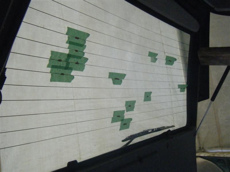

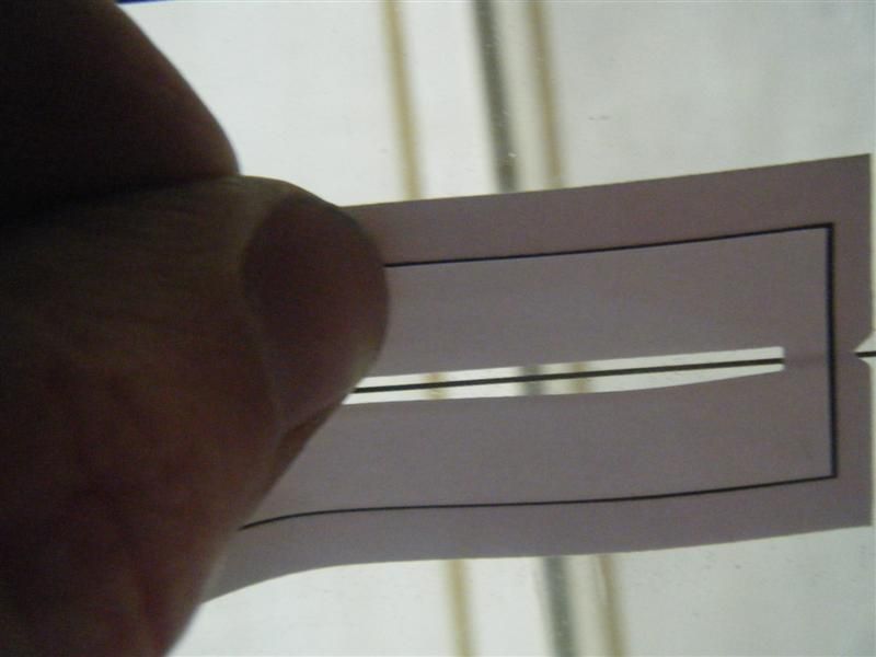

i got to this today. it's super easy but the repair kit is a total piece of crap. all you need for repairing the grid is the liquid and applicator brush. the alcohol prep pad left a film that the tape wouldn't stick to and the stencil you are supposed to use is about 3 times too wide. if you used the stencil you would wind up with huge thick portions where you repaired the grid so i used painter's tape instead and lined it up right next to the grid lines.
here are the many repaired spots.
this illustrates just how oversized the stencil is.
it says to wait 24 hours to test the defogger so i'll try it out tomorrow night.
