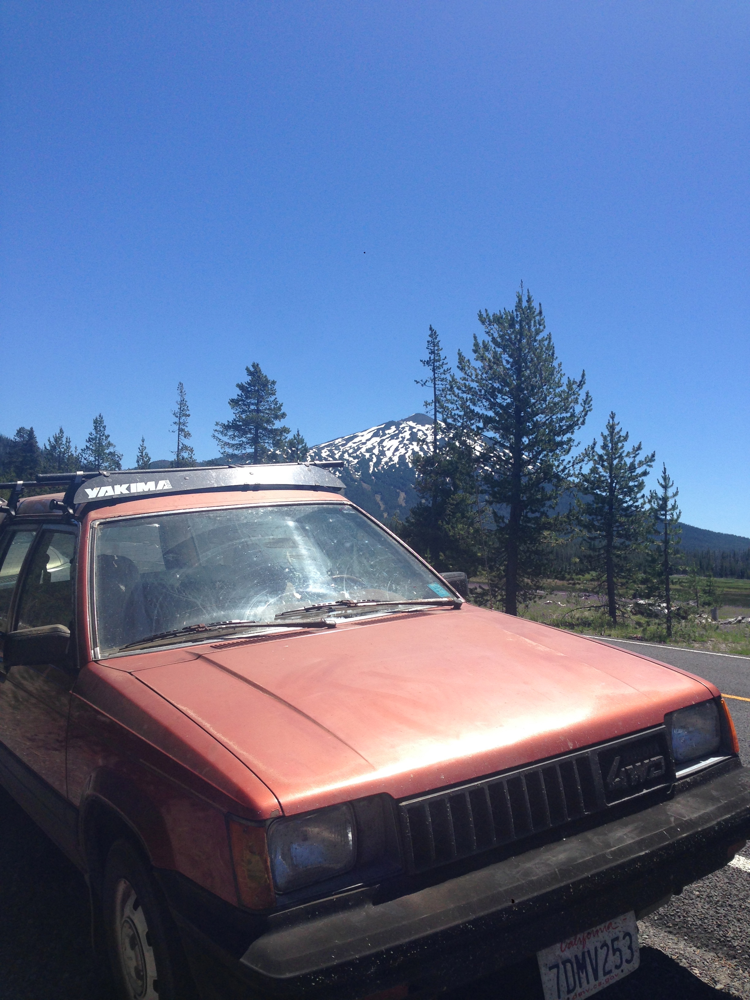

Hey Everyone, I'm said to let her go, but it's time. I was returning from Bend,OR back to Northern California, and my Tercel blew a headcasket. The cars name is Patty Labell (aka the Patty Wagon). She's at a mechanics in Prospect, Oregon. He's willing to do the work or scrap it. I'd hate to scrape her. It'd be great if someone made and offer and got her back on the road. I'm going out of town this weekend, but leave messages and I'll get back on Monday.

more information on the car would be good. what does it have, how many miles, recent repairs/upgrades, etc.? More pictures, that looks like a nice roof rack, is that included too?

The gasket is so bad it won't start, and is blowing smoke/exhaust out the radiator. Oil is leaking. She's in rough shape. Thats why I'm saying complete rebuild or new engine. Anyone want to take a gamble...Like I said, its in Prospect Oregon. Make an offer of a few/several hundred, and its yours. The garage owner has been cool keeping it there, but I want to get it off his hands asap. If an offer don't come in today, I'm releasing the title so he can scrap her:(
