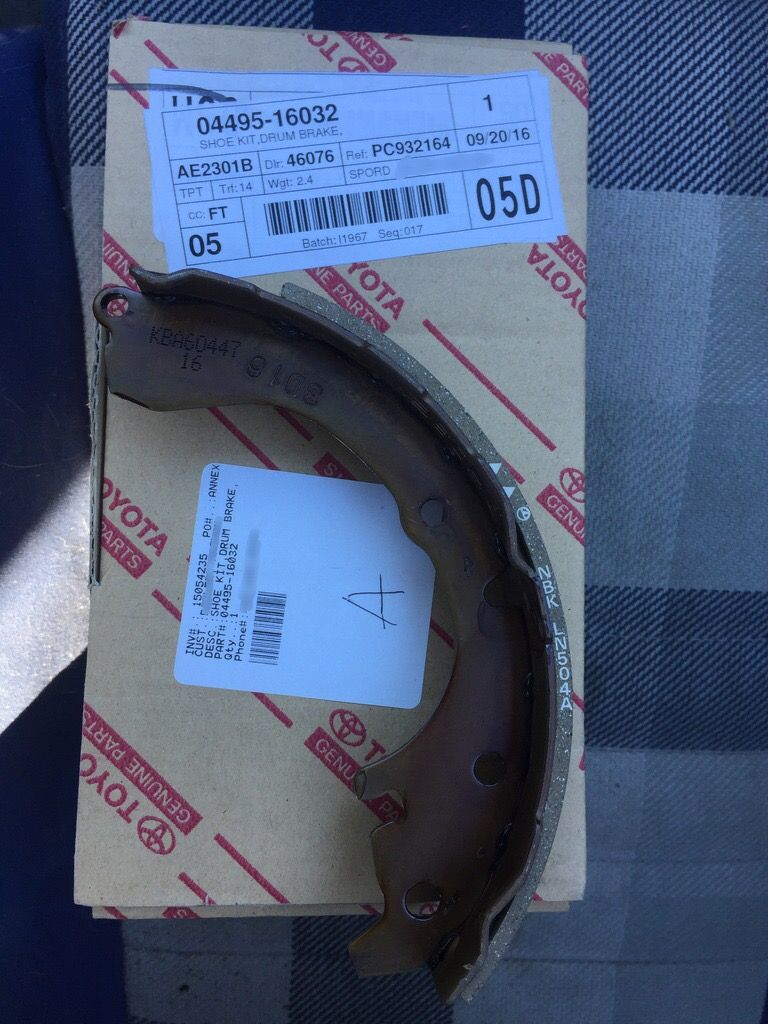

Postby helipilot77 » Wed Sep 21, 2016 9:57 pm
Well here they are although I can't really tell if they are made by a third party.
. / TOYOTA
./_| |/|/ |]
Posts: 9345
Re: Another Seattle AL25 member
Postby Petros » Wed Sep 21, 2016 10:41 pm
no logos I can find, except that circle with a sylized "T" in it stamped in the edge of the lining material. running all of the part numbers only yield "made by toyota" everywhere these part numbers were listed.

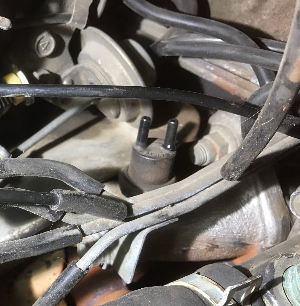

Postby helipilot77 » Tue Oct 11, 2016 3:47 pm
Today after work I started going through my vacuum lines and one-by-one replacing them. Unfortunately one of the nipples broke off the vacuum fitting on the number 1 intake runner (Gas Filter). Must have been very heat enbrittled cause I was being very careful with them.
Does anyone in Seattle have a spare I could buy? Or anywhere for that matter, I'll pay shipping.
. / TOYOTA
./_| |/|/ |]
Posts: 9345
Postby Petros » Tue Oct 11, 2016 4:22 pm
These were used in a lot of different toyota models in the 80's, you should be able to find one at PicknPull, there are two 80's Tercels (one is 4wd) in the Arlington picknpull right now. likely you can find something in the Lynnwood one that will work. I think you can still buy them new as well.
I might have one somewhere in my boxes of junk, I may have to travel to lynnwood tomorrow evening, if you do not find one perhaps we can meet wedesday evening and I will give it to you.
all it does is have a baffle to prevent fuel from going up into the vacuum system.

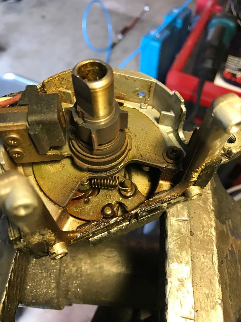

helipilot77
Posts: 265
My tercel:: 1984 SR5 wagon
Location: Seattle, WA
Postby helipilot77 » Sun Oct 23, 2016 4:52 pm
I think I may have found the problem.
As you can see my distributor is seized at full mechanical advance. Do you guys think this is the source of my problem? It's very stuck! I think I'm going to have tear it apart to free it up.
