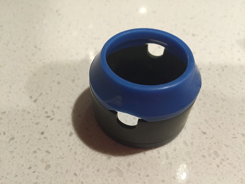

Yeah I think so. The blue one for the Rf1a transfer case shifter looks to be the right shifter seat bushing (the blue one) and I got the socket bushing for the L43 side shift transmission. I bought the original Toyota Tercel parts to compare them. The seat looks like the right one however the socket bushing on the tercel is a bit thicker. So I would stick with the factory socket bushing. I haven't yet fit the shifter seat yet so don't place your order until I confirm it.

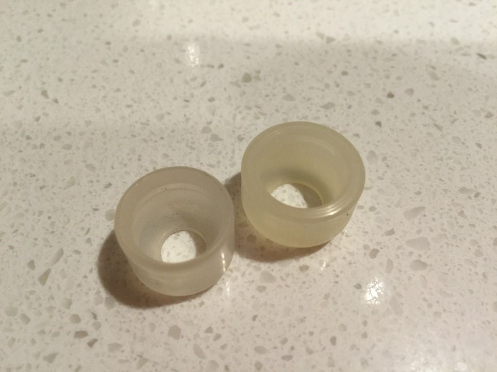

Here you can see that the original part is a little thicker.
The one on the right is the Toyota part

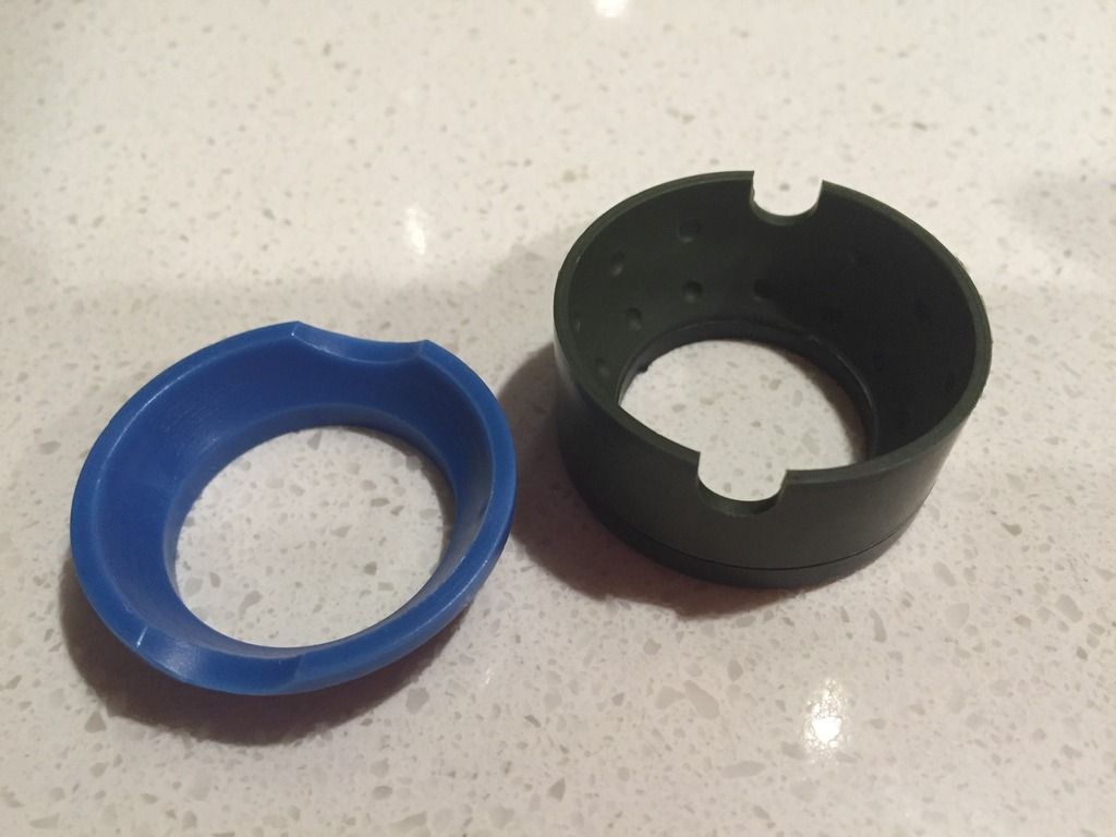

And here are the shifter seats

I got a chance to install the new Marlin Crawler shifter seat yesterday. It fit perfectly. I took it for a short little test drive and the shifting is so tight and precise. If you are looking to improve the feel of your shifter I highly recommend this very cheap improvement.
