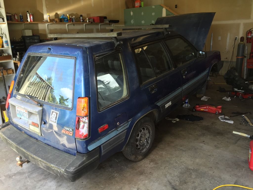

Hello fellow members. I am brand new to the site and have recently puchased my second 1984 4WD Tercel Wagon (I sold my first one years ago). She is a blue SR5 model in pretty good condition.
Original paint and hardly any dents or rust (a couple little dings that have some surface rust on them. I bought her for $600 because she needed a clutch. I picked her up on Thursday and loaded her onto my buddies tow dolly to head to his place where we would replace the clutch.
Not sure yet what I have planned for her other than cleaning her up getting her tuned-up, fixing the clutch and having a look at all the systems before daily driving her.

So today my buddy and I wanted to get started on the clutch replacement. Before we got started we needed to move the car from the street were I parked it after unloading from the tow dolly. We wanted to do the work in his garage but we need to get the tercel up his very steep driveway. So using the pickup and a tow strap we towed it up the driveway until the truck couldn't pull forward any further without being trapped in front of the tercel. Then we chocked the tires and set the e-brake to make a plan on how to get it the rest of the way in. Using a pulley and some webbing and rope we hooked onto the tercel with one end of the rope then thought the pulley and to the truck. I started creeping down the the driveway in the truck and then stared to load the rope. Once all the tension was out of the system I creeped slowly forward and the tercel started to creep up the driveway and into the garage. It had just started moving forward when the webbing broke and the car rolled backward a few feet then hopped over the wheel chock and picked up speed as it rolled down his driveway towards the neighbors house.
The drivers side door had been left ajar and after it crossed the street it caught some bushes and ripped the door open which slowed it down and possibly even stopped it.
So now my nearly pristine tercel is in need of a door and fender and of course some paint.
After all this we started to tear into the clutch replacement job. What a bear that transmission is to remove and install. Just not enough room!
After we got it out we pressure washed the 33 years of grease and dirt off it and prepped everything to go back together.
I just have to say how comically small the clutch in these cars are after being use to the clutch in my diesel 4Runner.
The surface on the flywheel looked pretty good so we hit it with an orbital sander to rough it up a bit and put the clutch together. After about two hours of wrestling we got the transmission back in. After looking at the condition of the front axle CV's I decided not to reinstall the old ones and will be replacing them with some new units.
