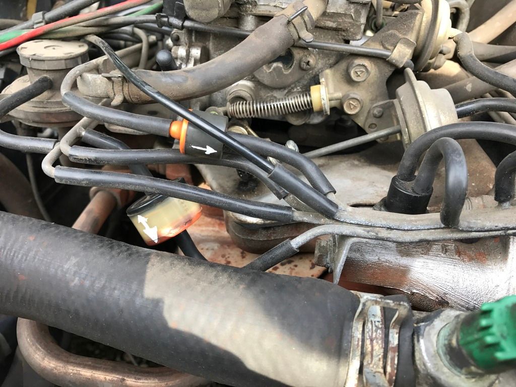

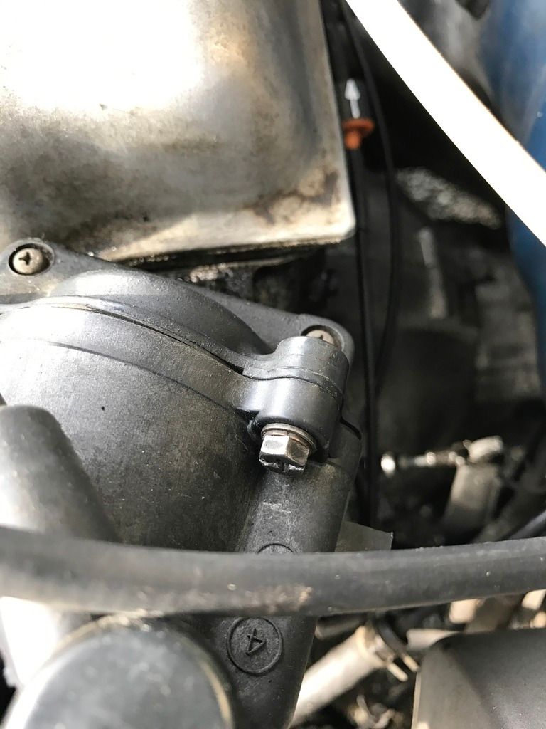

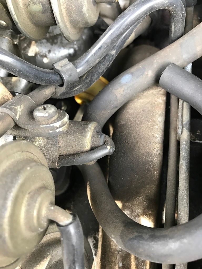

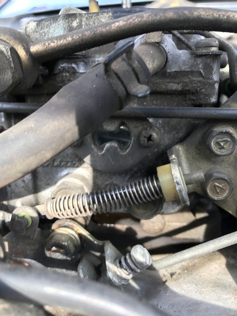

Maybe you guys could look at my vacuum lines and double check my work?
I am also wondering if got the check valves installed the right way?
Here is the one behind the head that goes to the distributor vacuum advance.
Here is the one between the valve cover and the carb.
Here are the two in the front of the carb.
