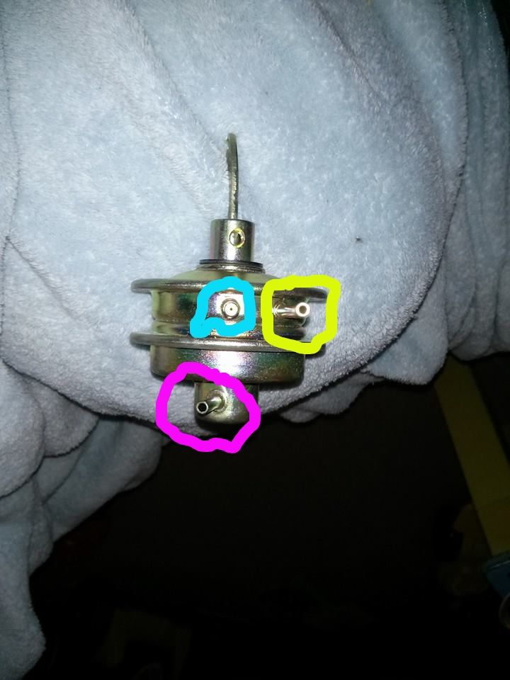

first though, it is important to note that you should plug the port on the advance unit circled in blue in the second pic below because it will not be used. next, stick a hose on the other two ports and suck to confirm whether they are still good. if you can suck air through, that diaphragm is ruptured, and that's bad. all hoses going to ruptured diaphragms should be removed and the ports plugged until the unit can be replaced. if the diaphragms hold vacuum, all is well and you can proceed.

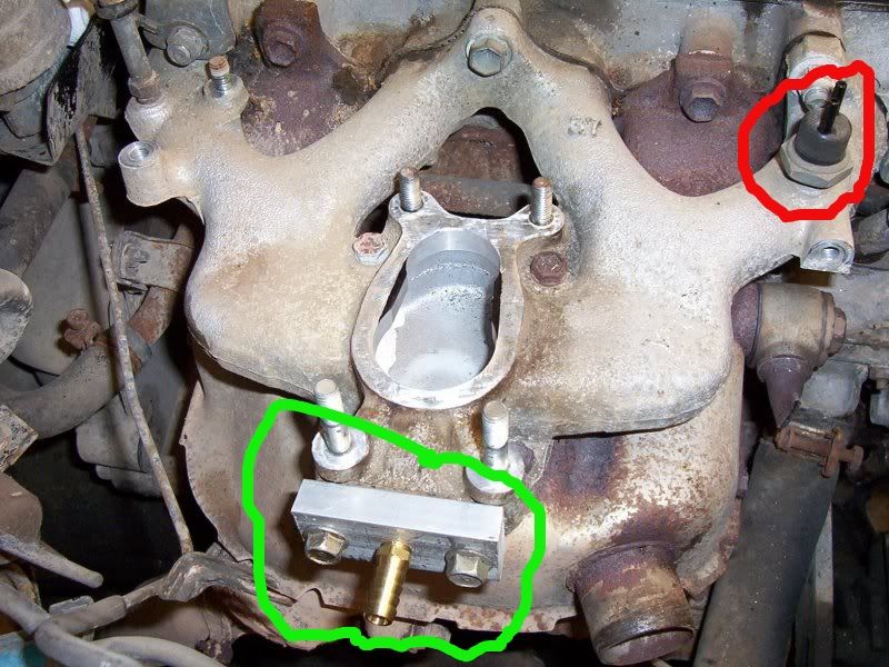

1) PCV to intake manifold - how this one is routed depends on whether your weber fits under your hood with the phenolic spacer underneath the weber's adapter plate. if you still have your spacer, leave it set up as it was with the stock carb. if you have to delete the spacer, you will have to make a new port where the EGR used to sit. this new port is shown in the first pic below circled in green, courtesy of splatterdog. this one recirculates crankcase gases into the manifold to be burned off in the combustion chambers.
2) manifold vacuum to upper advance unit port with larger hole - the manifold vacuum ports are shown in the first pic, circled in red. the correct advance unit port is in the second pic, circled in yellow. this one advances the timing 8* at idle and highway cruising for improved fuel economy.
3) weber's vacuum advance port to lower advance unit port - the weber's vacuum advance port is marked in the third pic. the lower advance unit port is in the second pic, circled in pink. this connection advances the timing 13* during highway cruising to improve fuel economy.
4) charcoal can to weber's EGR port - the purge port of the charcoal can should be connected to the EGR port of the weber, marked in the third pic. any other ports on the can should be capped, and any electrical plugs disconnected. the charcoal can stores gasoline vapors until vacuum in the carb draws them out during cruising conditions.
